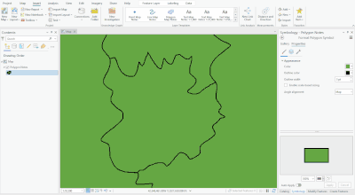

Here is how you can generalize (simplify) a portion of a polygon.
  1. Add a new (temporary) line feature to the map.
  2. Create a new line using the trace tool that follows the polygon edge you want to modify.
  3. Enable Map Topology in the map.
  4. Select the new line with the generalize tool > Simplify method > set offset value > click Generalize. The portion of the polygon was generalized (as well as the polygons that share the edge)
  5. Now you can delete the temporary line.
 GIF:
