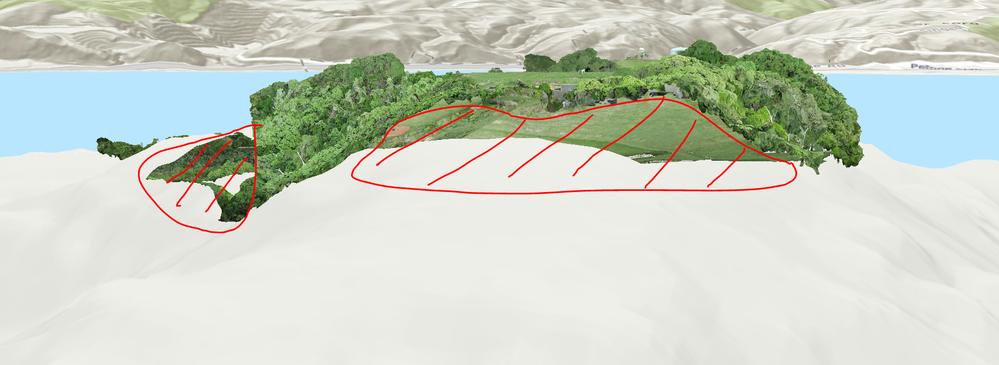

In the ArcGIS Enterprise/Online 3D Scene viewer 3D Meshes often appear in the view over Raster/Imagery/Ground layers.  This results in some very unnatural results and is very disorienting to the user.
For example in this scene a large hill is circled in red and a mesh model is circled in blue:
When I change to a low angle the mesh is visible through the hill.  This looks really bad and is not at all how it should behave:
Can you please improve the interaction of different layers so they make sense visually.  If objects are behind something else they should not be seen:

I just loaded a slpk into ArcGIS Pro 3.1 and I see that no progress has been made on this issue.  The mesh layers are still showing when they should be hidden behind draped tile layers.  This makes the whole 3D visualisation look like trash, and also makes it hard for the user to interpret the relationship between different layers.
I have highlighted areas of the mesh that should be obscured by the basemap but aren't.

After discussing this with some other folks, I have some more information. Integrated mesh layers are currently designed to be always displayed on top of other content in the scene. All clients (ArcGIS Pro, Scene Viewer, JSAPI apps etc) use stencil buffering that allows the mesh to draw into another buffer and display it on top of the rest of the ground at the end of each frame. This is why the mesh is not occluded by other ground-based draped content.
We do currently have on the ArcGIS Pro roadmap the ability to use Integrated Mesh layers as part of the Ground Elevation Surface which would ameliorate these effects. This is a major design change though that would have impact across the ArcGIS Platform and is not a trivial change that can be implemented quickly. There may be other smaller design changes we can make such as allowing you to turn of the stencil-buffering but we will explore this with other teams to determine the best outcome.
