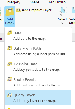

Step 1:
11

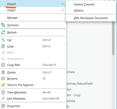

Step 2:
22

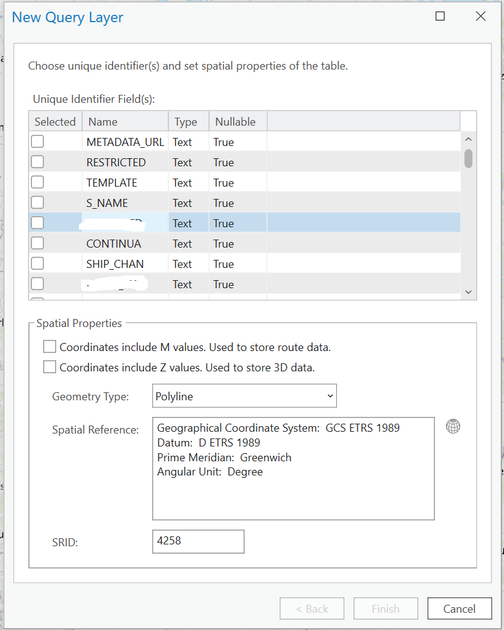

Step 3:
33
This Step 3 can take a while. It would be nice if one could define a filter within Step 2.
AlfredBaldenweck
Wait.

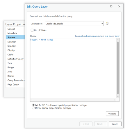

Unless I'm missing something, why aren't you using a Where clause in that Query layer?
TorstenFay
Hi, @AlfredBaldenweck , you mean via Properties -> Source -> Query... but this is only possible after loading in the whole table. As far as I know...
AlfredBaldenweck
Nope, I think you have your order of operations wrong.
