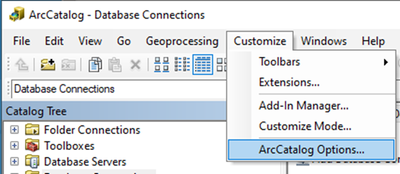

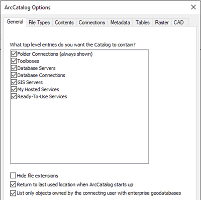

Hi Bud,
If you are using ArcGIS Desktop, you can accomplish this by going to Customize > ArcCatalog options... > check the "List only objects owned by the connecting user with enterprise geodatabases" checkbox.
