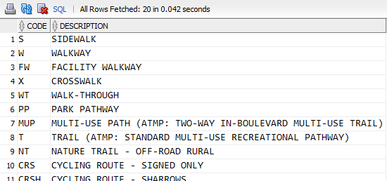

Need to access FGDB system tables using SQL. For example, provide a way to query for domain values (codes and descriptions) for a given domain.
We can do it in enterprise geodatabases like Oracle EGDBs.
What I do is create individual views to get the domain values (codes and descriptions) for a given domain.
The old way (EXTRACTVALUE has been deprecated in Oracle):
create or replace view d_atn_type as
elect substr(extractvalue(codedvalues.column_value,'CodedValue/Code'),1,255) as code, substr(extractvalue(codedvalues.column_value,'CodedValue/Name'),1,255) as description from sde.gdb_items_vw i join sde.gdb_itemtypes it on i.type = it.uuid, table(xmlsequence(xmltype(definition).extract('/GPCodedValueDomain2/CodedValues/CodedValue'))) codedvalues where i.name = 'ATN_TYPE'
The new way (using XMLTABLE):
select cast(rownum as number(38,0)) as rownum_, x.code, x.description, i.name as domain_name from sde.gdb_items_vw i cross apply xmltable( '/GPCodedValueDomain2/CodedValues/CodedValue' passing xmltype(i.definition) columns code varchar2(255) path './Code', description varchar2(255) path './Name' ) x where i.name = 'ATN_TYPE'

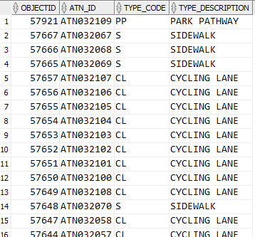

Then in a query/view where I'm selecting data from an EGDB table or FC, I join from the field that has the domain code to the domain view to get the domain description:
select
    objectid,
    atn_id,
    type as type_code,
    d.description as type_description
from
    infrastr.active_transportation a
left join
    infrastr.d_atn_type_vw d
    on a.type = d.code
But that's not possible with file geodatabases, since we can't access the system tables via SQL.

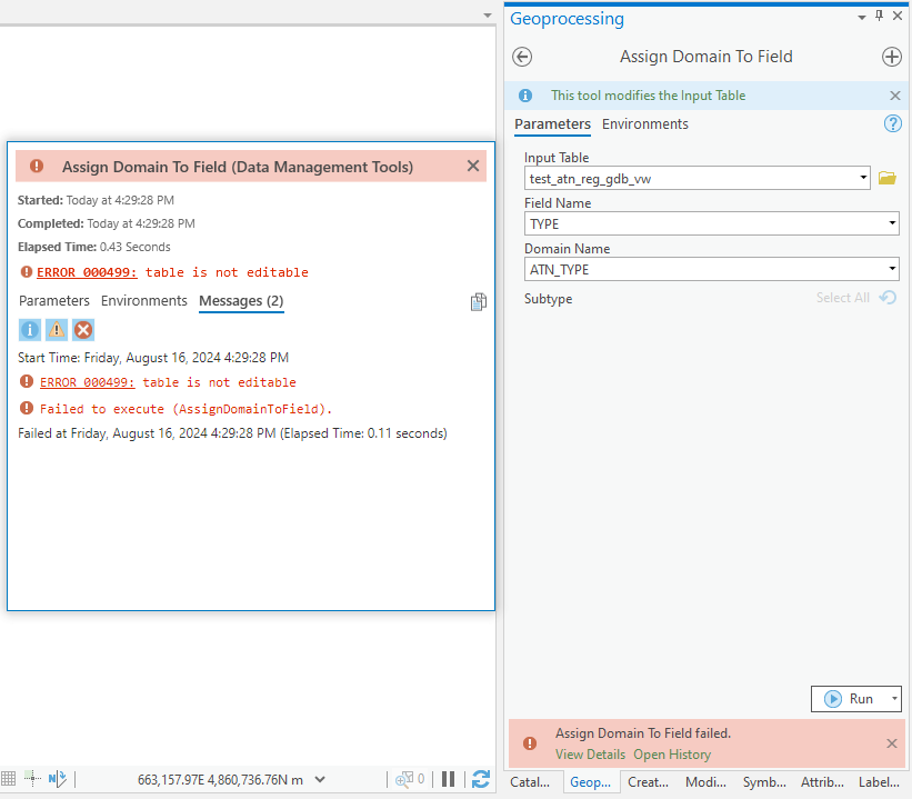

I tried to use a domain on a FGDB database view (registered with the GDB), but unfortunately, I got an error:
ERROR 000499: table is not editable
However, it did work with a registered database view in a mobile geodatabase. And as mentioned in my previous comment, it works in an enterprise geodatabase too.
Bud
Esri Support Case:
#03701528 - Database view (registered with GDB) — Assign Domain To Field works in eGDB and mGDB, but not fGDB
