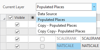

I'm working in a project where we have the same dataset in the TOC twice, symbolized differently. I wanted to rearrange the fields within the project, so I did on one of the two layers. This method does not update the field order at the database level or in the other layer, so I needed to update the second layer, too. I tried to open the fields view of the second layer side-by-side with that of the first one so I could make the field order match, but was surprised when the second view replaced the first rather than opening side-by-side. I can simultaneously open multiple field views with different sources now in Pro, so I know the issue has to do with layers with the same source. I can also open both attribute tables separately, so it would make sense to me if I could open both field views separately too.
My workaround for now is just taking a screenshot of the order.
