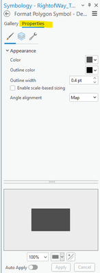

I too loved ArcMap.    if you double left click on a symbol in Pro instead of right click, it will bring up the symbology attributes box.  similar to ArcMap.  click on the Properties if it opens on Gallery.     It should remember the next time you double left click on a symbol and open in Properties making it quick to change.
