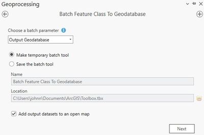

JohnNergeBrooklynPark
Small addition. I tried batching the Feature Class to Geodatabase tool and thought maybe I found the solution because it includes a checkbox to Add output datasets to an open map. However, I think this might just be a default checkbox on all batched tools as it did not add the outputs to my map when run.
