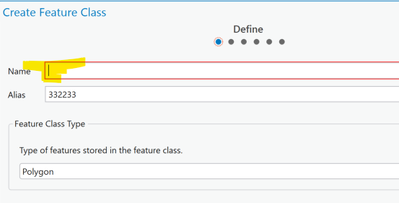

It would be helpful if we could name a FC starting with a number, such as a property address: 123_Main_St.
Currently, that doesn't seem to be allowed; a FC can only start with a letter.

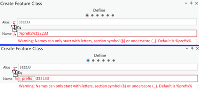

I agree with @VenkataKondepati that some form of automated alias handling would be neat.
There is no feedback on why you can´t type in a number:
Ideally switch Alias and Name fields and add a "copy values over" button.
If the Alias starts with a number, inform the user that the Name cannot start with a number and suggest an alternative such as underscore number by default. Bonus point if the ArcGIS Pro Settings get an entry to specify the default prefix for Names that would usually start with a number %prefix%
