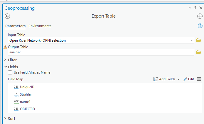

DuncanHornby
@ReidHarwood11397 The Export Table tool has had its fields mapping interface much improved with ArcPro 3.2.  They have removed the annoying feature of it forcing you to have an OID_ field in your csv file. They have given you much more control over what the field output is and in what order.  In the example below I have included back the objectid field to show that you can indeed "put it back" as well as moving it to another position.  Or in my user case get rid of it completely. Nice!
There is a really good blog you should read - ArcGIS Pro 3.2 Field map enhancements and design updates (esri.com)
