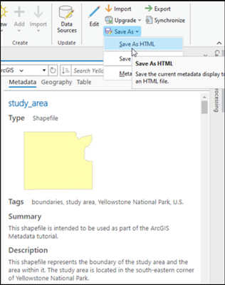

The capability for the main idea here is already offered in ArcGIS Pro via the Save As HTML command on the ribbon, Catalog tab, Metadata group:
Whatever stylesheet is used to display metadata at the time will be used to generate the exported HTML file.
@GeraldDaumiller1 -  the metadata display in Pro can be customized by creating a custom metadata style using the ArcGIS Pro Metadata Toolkit: https://github.com/Esri/arcgis-pro-metadata-toolkit.
