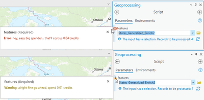

We currently don't offer a way to estimate credit usage for custom scripts. It is pretty complicated to account for custom python logic that would change the credit spend. But you could add logic to your script to stop the tool from running based on the number of features involved.
    def updateMessages(self):
        self.params[0].clearMessage()
        # get the count of the in_features
        feature_count = int(arcpy.management.GetCount(self.params[0].value).getOutput(0))
        # do some math
            # 10 credits per 1,000 attributes (data variables multiplied by total feature records)
            # only one data variable is being used in this example
            # https://doc.arcgis.com/en/arcgis-online/analyze/credits-analysis-mv.htm
        enrich_cost = 10/1000*feature_count
        # compare the results
        if enrich_cost > 0.02:
            self.params[0].setErrorMessage(f"hey, easy big spender... that'll cost us {enrich_cost} credits" )
        else:
            self.params[0].setWarningMessage(f"alright fine go ahead, spend {enrich_cost} credits" )
        return
this kind of validation stops the tool from running (or allows it to run) like this:
