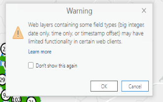

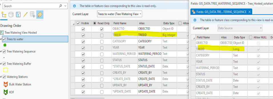

ArcPro and AGOL  also do not work well with Big integer. We don't have anything that is a big integer and only use long. If you look at the layer in ArcCatelog it shows as long integer but the data design view of the same layer shows it as big integer. If we export to AGOL it gives a warning message about big integer and sure enough, it is big integer in AGOL. I guess the bug is in ArcPro 3.2.2. Please fix
