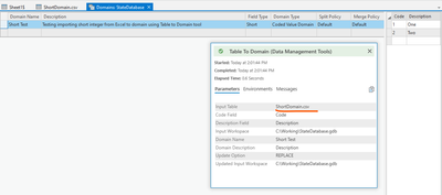

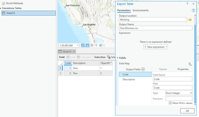

Once you have the Excel sheet in Pro, export it to csv and set the output datatype for the code as Short.
The csv now has the Short datatype for Code.
Then run Table to Domain using the csv table as input.  Should work:
