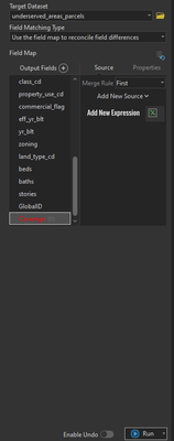

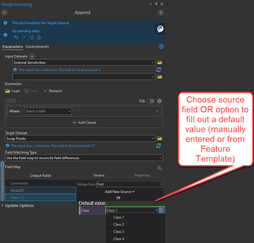

When using the Append geoprocessing tool, you have the option to use the field map to reconcile field differences between the Input data and Target data.
My idea, is that when you do use this method, you have an additional option under field sources to input a default value for those fields that don't have a match. In my example below, I'm appending data from one layer with a simple Label option, into another layer that has a corresponding "Comments" fields, but also a "Class" field with 4 class options (for basic data categorisation). It would be a good time saver, if in the Class Field, I could either type in a default vale that is added against all appended features, or alternatively, select an option from the Feature Template. Obviously, it would be fine if left blank, or would not be used if a source field is mapped.

LindsayRaabe_FPCWA
@Bud I could see those types of options being of value in some cases (just not in my posted example). Could even be a drop-down list of options under the Default Value, or custom value.

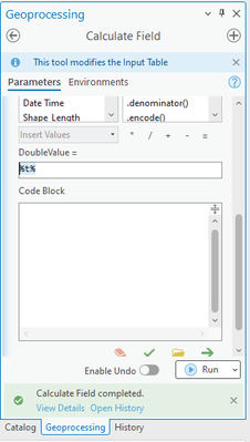

JonathanNeal
@Bud Tools support %t%, but looks like I can only make it stick to a double field, not a DateTime field.
