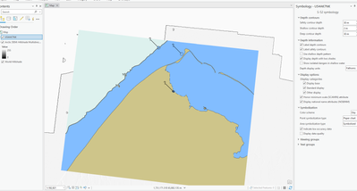

GuyNoll
Hi Marcel,
I opened Arctic DEM: Hillshade Multidirectional from The Living Atlas into a new project in Pro.
Projected Coordinate System WGS 1984 EPSG Alaska Polar Stereographic
Projection Stereographic
WKID 5936
Authority EPSG
Linear Unit Meters (1.0)
False Easting 2000000.0
False Northing 2000000.0
Central Meridian -150.0
Scale Factor 0.994
Latitude Of Origin 90.0
I was able to drag and drop the NOAA ENC sourced at  https://charts.noaa.gov/ENCs/US4AK7NK.zip into this map.
It looks like:
MarcelSt-Germain
@GuyNoll
Exactly my point.  You are in wgs84.  So just a viewer not in par with arcmap where you can download in a projected map only one layer an be able to make query and calculations.

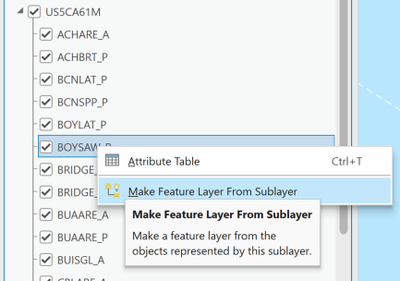

TomDePuyt
ArcGIS Pro 3.3 has a lot of improvements to the ENC Layer functionality.   I believe the introduction of sublayers and the ability to 'Make Feature Layer from Sublayer' allows you to have more control of the symbology and labels of those features.  It also allows you to leverage the feature's geometry in various editing operations.
Please let us know of these enhancements at ArcGIS Pro 3.3 do not address your workflow needs.
