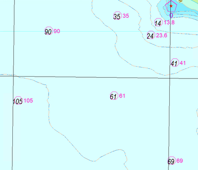

MarcelSt-Germain
@TomDePuyt
Hi Tom,
You can see in the screen capture that 3 ENC was displayed, depth, contour and rock.
The contour is just displaying itself without labels.  The rock is located by a pentagon with its value under it.  The depth annotations are located with an octagon and the value on the right of it.
We use this feature since S-57 Viewer was integrated in arcmap.  It’s a simple and fast way to see if we have to correct the annotations when applying notice to mariner changes.
If we saw change, we just have to delete the annotations and doing convert lable to annotations to replace them.  The only drawback is to do manualy populate the TiledID field since we can do it automatically.
In Pro, we lost this basic feature and worse, you remove the append option to convert lable to annotations (maybe it's return with 3.3).  Like ESRI has always wanted to make Pro less productive than arcmap.
So, the ENC picture you show now is maybe nice but unusefull for us.  We need the S-57 viewer come back.
