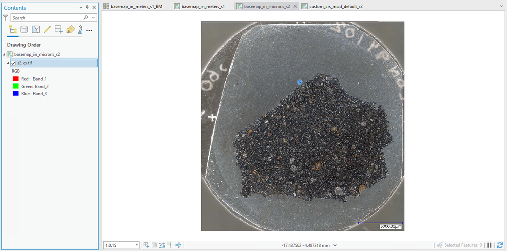

The OSIRIS-REx microscopy data goes down to the nanometer scale, but unfortunately, ArcGIS Pro and the Map Viewer tool do not currently support the visualization and measurement of data with a sub-centimeter resolution.  Beyond the centimeter scale, both tools cease to permit zooming-in.  Further more, when looking at coordinates or using the measure tool, the smallest metric unit available is meters and the precision is limited to 2 decimal places. This means any value smaller than 1cm is just reported as 0.

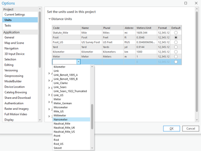

@MathildeWestermann-GISTO2016 I see nanometer as an option:

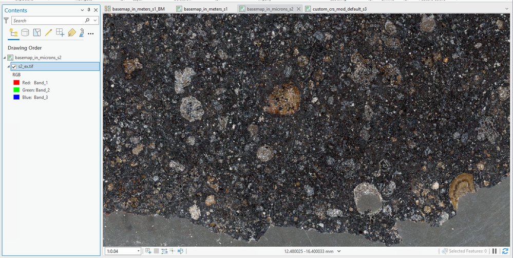

@KoryKramer , Thank you yes I have seen this and it resolves the measurement issue in ArcGIS Pro, but not in ArcGIS Enterprise Map Viewer.  Also, most importantly it does not resolve the zooming-in issue.  Regardless of the selected measurement units in ArcGIS Pro or ArcGIS Enterprise, I cannot zoom in on my data beyond the cm scale.  Below are two screen shots to demonstrate the limitation.  The first screen shot is the full extent of a sample basemap.  The second screen shot shows how far I can zoom in.  You can't even resolve a pixel. Screenshot 2023-07-11 at 9.28.24 PM.pngScreenshot 2023-07-11 at 9.28.37 PM.png
