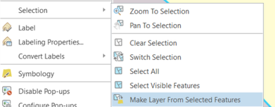

Hi @DuncanHornby I just wanted to check to make sure that you're using the layer with the selection rather than browsing to its datasource to set the Mask environment setting.
I haven't tested this, but if the layer's selection isn't being honored, have you tried Make Layer From Selected Features and using that layer for the mask?

Yeah definitely using a layer rather than a datasource. I had not considered making a temporary layer based on the selection so I tried what you suggested. But that too is ignored and the selection layer is treated as if it was the original layer without a selection. So that seems like a bug to me!
But ideally and in keeping with the behaviour of all other tools I would like to see the mask honour selections and I don't have to go through temporary layers.
