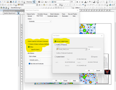

I may be misunderstanding your idea but if you right click on the dataframe in layout view, select properties from the menu, and set a fixed extent on the data frame tab it locks the data extent of the dataframe, there is also the option to set the scale here. Unfortunately, it also locks it in the data view as well.

I second duri's comment.  Setting a fixed scale/extent in data frame properties is only a partial solution because, as DougR pointed out, it also locks it in the data view. In AutoCAD one can lock a viewport in paper space (equivalent to the data frame in layout view in ArcMap) but it has no effect on model space (equivalent to data view in ArcMap). This would allow one to concentrate on map design in layout view without accidentally changing data frame scale or extent but still allow zoom/pan in data view during data editing.
