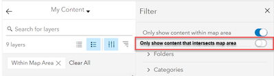

Following up from a few long years ago...  The ability to spatially filter content search in ArcGIS Online or Portal web maps is also limited to a single option-- "Only show content within map area".  This is a bit confusing as it is not clear if it is a spatial intersect or within.  It would be great in the web map viewer to have an option for both.

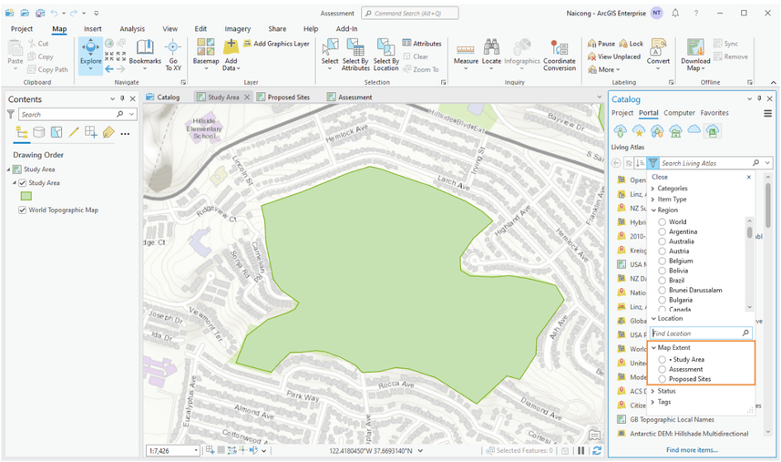

Hello @RogerBannister and everyone,
With the release of ArcGIS Pro 3.2, you can now filter portal content using a map extent, which would return portal items whose footprint intersects with this map extent:
The spatial relation used in this case is Intersect, same as what you would have on ArcGIS Online.  You also have the additional feature of choosing which map extent you want to use among the open maps in your project (the active map is marked - see the screen capture above).  You can access this Map Extent filter in the Catalog pane, Catalog view, as well as in the Add Data browse dialog where the active map will be the only choice in the Map Extent filter.
For more details on using the Map Extent filter for portal items, please see https://pro.arcgis.com/en/pro-app/latest/help/projects/search-portal-items.htm#ESRI_SECTION1_91B65E1... under the "Use spatial filters" heading.
