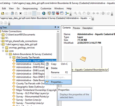

This should be very simple. I want to be able to view the layer (.lyrx) properties by right clicking on the layer in Catalog View or the Catalog Pane. Below is a screen shot of this context menu option in ArcCatalog 10.x. Beneath that is the screen shot of the context menu with this functionality absent in ArcGIS Pro 2.9.
ArcCatalog 10.x:
ArcGIS Pro 2.9:
