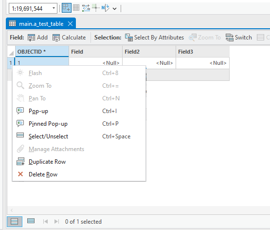

When viewing a standalone table in the attribute table:
It would help to be able to open the attributes pane by right-clicking a row —> Attributes.
I'm aware that we can open the attributes pane from the Map and Editing ribbons. But the user might have a different ribbon open, so it would require an extra click. Or, new users might not think to look for the Attributes button in the ribbon when exploring rows in the attribute table. A right-click option in the attribute window would be more obvious and convenient.

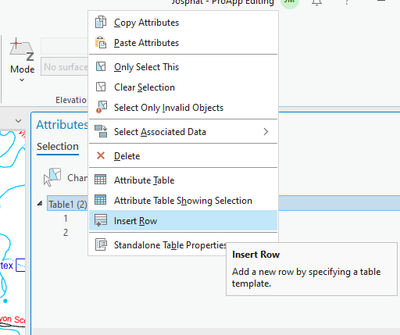

@AlyciaRajendran_esri the present ArcGIS Pro functionality kind of already does what you describe, if I am reading your question correctly, that is. At present, if the Attribute Pane is open, when I select a row, it appears in the Pane. If I right click a row, I have the option to "Select/Unselect", which performs the same function as holding Ctrl + Clicking a row, so I think adding an command to add the row to the Attribute Pane is a bit redundant. What I would love to see, is if Attribute Pane is not open or not visible, have the option to send the selected Attribute Table row to the Attribute Pane. Sort of the reverse of this when you right-click a feature in the Attribute Pane:
Instead, it would maybe say, "Attribute Pane Showing Selection", and would then open or make visible the Attribute Pane with the selection. This is essentially what clicking the "Attributes" command button on the Ribbon does, but if it was in the right-click menu, this would eliminate having to hunt for the button on the Ribbon and would speed up data editing.

JMutunga
@RandyCasey
because what I usually do is create a new row, then open the Attribute Pane to add new data, because the data entry tools are more robust in the Attribute Pane.
I just wanted to highlight that when working with Standalone tables, the Insert Row command within the Atribute pane enables you to add a new row which is then added to your existing selection.
To access the command, right click the Standalone table node in the pane, choose Insert Row and then follow instructions to add single or multiple rows.
