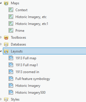

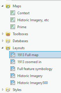

AlfredBaldenweck
The behaviour he's describing is consistent with my experience, too. (ArcGIS Pro 2.7.0)
I'm trying to replicate it  I can replicate it on some projects but not others, but frequently the Map will be duplicated along with the Layout, leading to several copies of the same map. I once ended up with 10 copies of the same map before I caught it.
Before DuplicationAfter
1913 Full Map's Data Frame is "Historic Imagery, etc"Duplicating by copy-pasting in the Content pane
AlfredBaldenweck_1-1631908742058.pngAlfredBaldenweck_1-1631908742058.pngAlfredBaldenweck_2-1631908814123.pngAlfredBaldenweck_2-1631908814123.png
Not sure what makes it happen, other than it only seems to happen on projects that have a lot of stuff going on. When I tried to replicate it in a new project, nothing happened, but it happens on the last two major projects I have.
Although it this clearly isn't intended behaviour, you end up having to work around by creating a blank layout and copy-pasting all your elements except the data frame into it.
