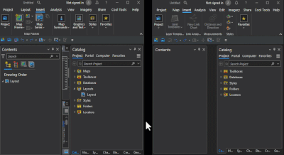

Example:
(the example is from a development build of 3.2 so you get a "Copy to Layouts" tip. That tip will not be present in 3.0.x or 3.1.x, but again, we have tested the functionality and the drag/drop is working in 3.0.x and 3.1.x).
Are you doing a drag/drop as I'm demonstrating above, or something different?
