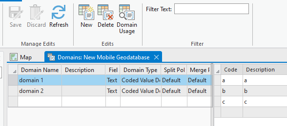

I've clicked a domain in the Domains View. I can see the code and description values in the section on the right.
If I hit refresh, the focus is removed from the domain, so the code and description values are no longer visible. It would be preferable to preserve the domain focus after the refresh button is clicked so that the user can see the refreshed values of the domain they were working with (without needing to re-click the domain).
Video:
(view in My Videos)
Use case for refreshing:
After sorting the descriptions in the Domains View, save the changes and hit refresh.
