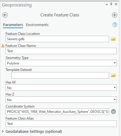

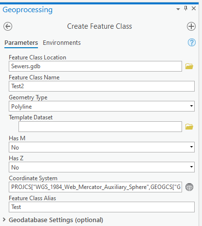

I have had issues with different tools, but today I was using Create Feature Class.  After further testing, here is the exact use case that causes the problem.
First, I run Create Feature Class with one set of parameters.
Second, I start entering another set of parameters, specifically the feature class name and alias while the tool is still running.
Third, when the tool finishes running, if the cursor is in either the feature class name or alias parameter fields, it kicks off an event handler which reverts the parameter field back to its last value and moves the cursor to the beginning of the field.  If you finish typing the parameter and click outside the text field, it will not revert it.
This creates a bad experience in a few ways.  First, if you don't notice it, you might have changed half of the parameters and run it with half old parameters and half new parameters.  Second, it is very annoying when it reverts back to the old value and moves the cursor while you are still typing.  You finish what you were typing at the start of the old parameter value and you have to clean up the mess you made or you accidentally run the tool with a junk value.

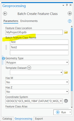

@NathanHeickLACSD Also, another thing to consider, that follows a similar workflow, is to run the tool in batch.
Steps:
1. Geoprocessing Pane>>right click the tool from search>>click Batch
2. Chose the parameter that you wish to alter, and click ok
3. Run the tool
Note: You can now run multiples and just change the name.
NathanHeickLACSD
If I wanted to use batch jobs, I would.  Are you limited to one field now?  Sometimes, I just want to run a tool once and make sure the parameters are good, then I run it a few more times.  I just like typing the parameters over and over into the original tool quickly.
