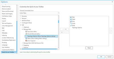

If you are using ArcGIS Pro 2.7 or prior release, you can add the Topology options command to the Quick Access Toolbar (QAT) using Customize Quick Access Toolbar capability.
Steps:
  1. From the ArcGIS Pro Settings page, click Options to open Options dialog
  2. On the Options dialog box menu, under Application, click Quick Access Toolbar
  3. Change Choose commands from to display List of Tabs as shown belowJosphatMutunga_1-1712601688645.png
  4. Expand the Edit tab then Manage Edits underneath
  5. Select Topology Options from the list then click Add
  6. Click Ok to save changes. Now you can see the active topology from QAT when working in your map.

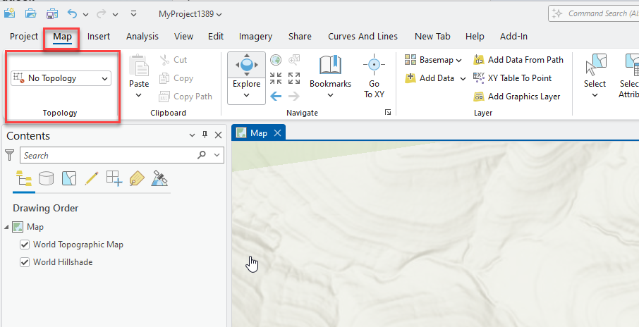

At 3.5 the topology combo box can now be added to a custom group on any ribbon tab:
