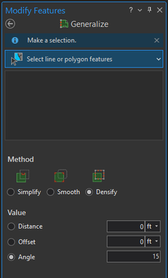

The Generalize tool found on the Modify Features pane has this option:
https://pro.arcgis.com/en/pro-app/latest/help/editing/generalize-a-feature.htm
