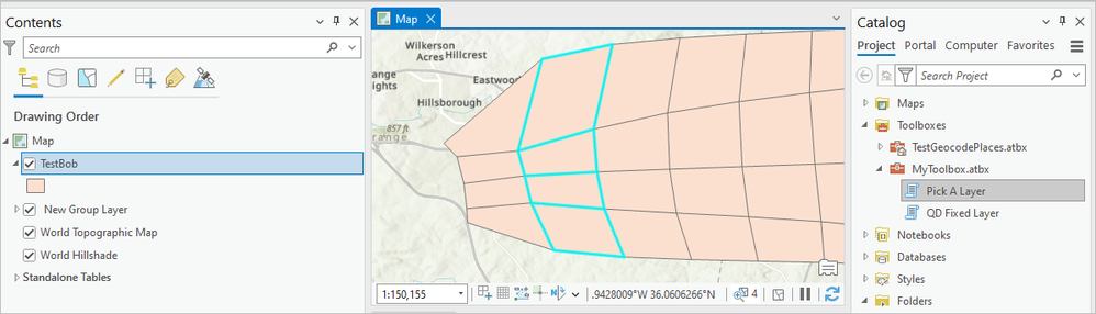

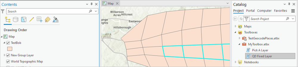

Script tool with no parameters, you would double-click the tool and click Run, and it would apply the definition query to the hard-coded layer.
def qdef_selected_features(lyr):
    desc = arcpy.Describe(lyr)
    # Get a semicolon-delimited string of selected feature IDs
    fid_list = desc.FIDSet.split(";")
    # build the query definition
    query = '{} IN ({})'.format(desc.OIDFieldName, ",".join(fid_list))
    # apply the query definition back to the layer
    lyr.definitionQuery = query
aprx = arcpy.mp.ArcGISProject('current')
m = aprx.activeMap
# I hard-coded my layer name, TestBob here
lyr = m.listLayers('TestBob')[0]

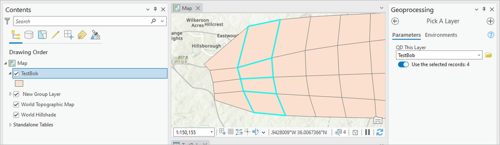

Script tool with a single input parameter that lets you pick the layer:
# configure script to accept a layer input from the script tool
lyr = arcpy.GetParameterAsText(0)
m = aprx.activeMap
thelyr = m.listLayers(lyr)[0]
qdef_selected_features(thelyr)
The difference is you can set the script tool to accept an input feature layer, so you can choose a layer from the map.
So you double-click the tool and see:

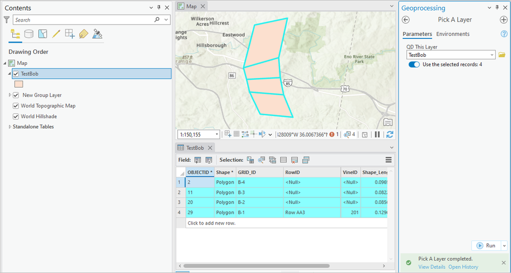

Click Run...
The hard-coded target layer gets its definition query updated.

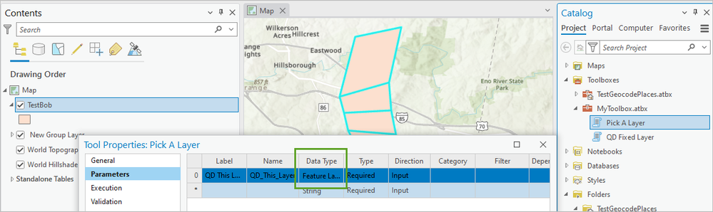

Versus the case where you set up a script tool with an input layer parameter:
The difference when setting up the script tool is you have to specify a parameter and set the type to feature layer.
