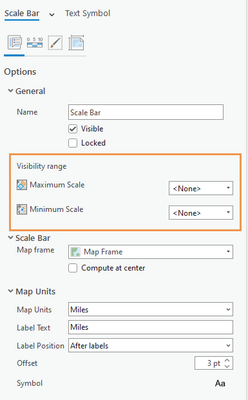

Status changed to: Implemented
In ArcGIS Pro 3.3 scale bars have a visibility range you can set. The scale bar will only be visible if the map frame is within that scale range. For a map series you can have multiple scale bars designed for different scales and use this option to make sure the optimal scale bar is displayed on each page.
