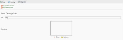

You can update to a custom thumbnail by opening the Catalog view > select the map of interest > on the manage ribbon, in the Metadata section, click Edit.
Hope that helps. Please let us know if that doesn't meet your needs.
AmyRoust
@SusanTran, that does help, thank you! It would be nice to have a button to do this in the Map Properties so that you don't have to dig into Catalog View, but this gets me close enough that I'm happy.
