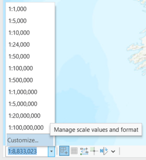

The list of available scale options for scale-based sizing come from the scale list at the bottom of the view. By default, 1,000 is the largest scale, but you can customize the map scale list with new scales and those will be available in the scale-based sizing menus. Expand the scale list menu and click Customize.
Add new scales to the scale list:...
...and they will be available in the scale-based sizing slider:
