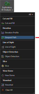

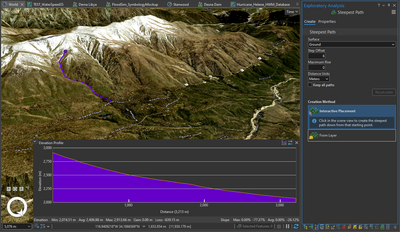

This tool is included in Pro 3.5!  It has been added into the Exploratory 3D Analysis drop down gallery list on the Analysis ribbon tab for 3D views.  🙂
There will be more detail in the Help, but figured I'd mention that we took this opportunity to allow you to set the sampled resolution of the ground surface, as well as an optional Maximum Rise property, to help you get the steepest path result to get past small blockages in its path - example below (with the path able to get past an up-to-5m-rise).
Run 1 - path goes 3kmRun 1 - path goes 3km  Run 2 - path goes 11kmRun 2 - path goes 11km
We also let you see the profile graph for the result, export the line to a feature, and so on.
