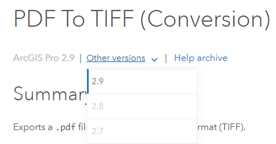

One way to see when a tool was added is to view the version dropdown:
https://pro.arcgis.com/en/pro-app/latest/tool-reference/conversion/pdf-to-tiff.htm
PDF To TIFF was added in 2.9 - note that 2.8 and 2.7 are grayed out.

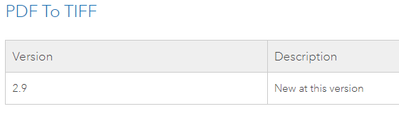

There are also history pages maintained for geoprocessing tools.  Following the example of the PDF To TIFF, we can look at the Conversion Toolbox History page https://pro.arcgis.com/en/pro-app/latest/tool-reference/conversion/conversion-toolbox-history-pro.ht... and see that it is new in Pro 2.9.
ThomasDilts
Thank you Kory.  I never knew about that page.  This is exactly what I was hoping might exist out there.
