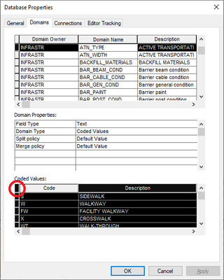

For what it's worth, copy/pasting works well in ArcMap. I use that functionality often; it's very efficient.
1. Click the rectangle in the top-left corner of the Coded Values section:
2. CTRL+C

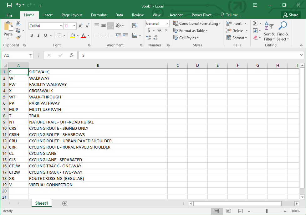

3. Paste in Excel:

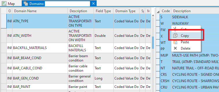

It looks like it ought to work:

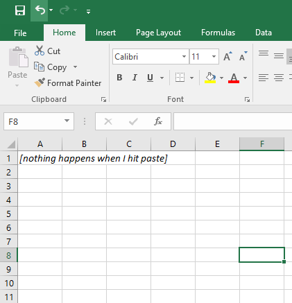

But when I try to paste the data in Excel, nothing happens; no data is pasted.
