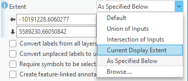

The Extent parameters in the Convert Labels To Annotation tool define the extent that will be converted and labels shouldn't be created outside that extent. Choose Current Display Extent from the Extent menu to pre-fill the extent parameters describing the extent of the layout.
If you're already doing this and still getting anno created outside your map's extent, I recommend contacting Technical Support  and they will be able to carefully troubleshoot the issue you're having with your map.

The Convert Labels to Annotation tool has an extent parameter.  Select the Current Display Extent option to base the extent on the active map or scene
