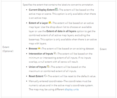

The extent control has changed at Pro 3.2
At Pro 3.1 it is as you describe above.
At Pro 3.2 the control changed as seen below
this should make the workflow more straightforward

Op here....thank you @WendyHarrison !
