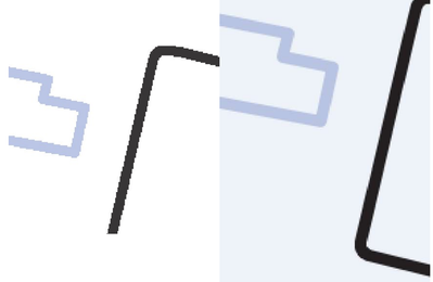

Hello dear @ChrisAnsorge ,

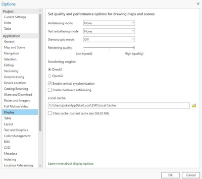

were you able to test this possibility in Display Options?
Currently, we trying to turn off antialiasing but we are not successful.
Our result is on the right site. But we need the left site.
Any ideas?
David

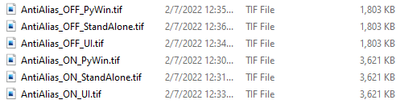

JeffBarrette
David, Are you using ArcGIS Pro 2.9?  I just compared output again and antialiasing settings are being honored as expected.
If it is NOT working as you expect, please include a sample export line of code.
p = arcpy.mp.ArcGISProject('current')
lyt = p.listLayouts()[0]
lyt.exportToTIFF(r"C:\Temp\AntiAliasing\AntiAlias_OFF_PyWin.tif", 300, '32-BIT_WITH_ALPHA', 'LZW', 100, False, False)
