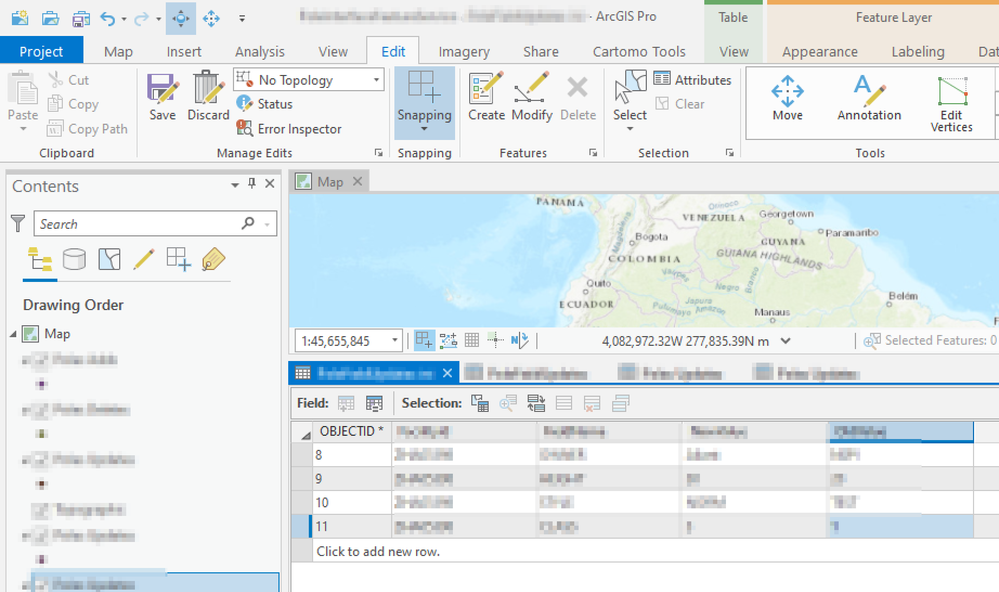

I would like to suggest a context-related Ctrl+S behaviour.
When I edit something in the attribute table, I would like to be able to save my field changes with Ctrl+S.
There should be a context-related behaviour depending on which panel is focused. If someone is editing features in the attribute table, I bet with you, most of the user wants to save these changes.
To avoid unwanted changes, a confirmation dialog could be shown asking if the user wants to save the project or the edited data. (Add a checkbox, so the user can decide if they want to confirm always or the context-related behaviour by default.)

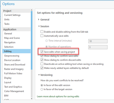

Have you looked into the following options?
Using the existing options, you can save edits when you save the project and you will get prompted to save those edits or cancel (the project will always be saved):

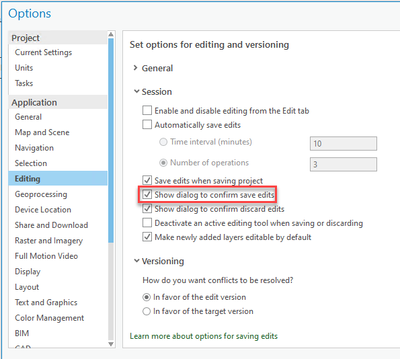

Uncheck 'Show dialog to confirm save edits' if you don't want to be prompted to save edits every time:

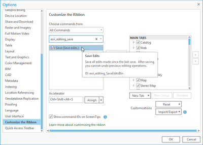

If you need a shortcut for saving edits only, you can set an accelerator (custom keyboard shortcut) for the command with the following ID: esri_editing_SaveEditsBtn:
Here I'm using Ctrl+Shift+Alt+S
