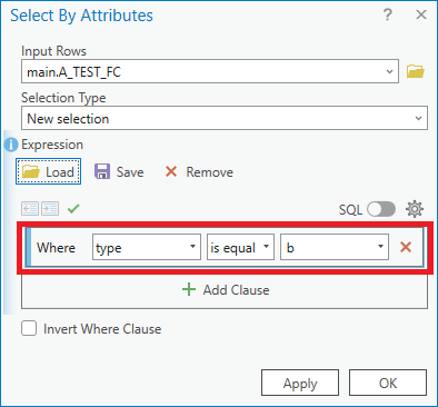

If I load the .exp SQL expression into the tools listed in the SQL Expression documentation, most of the tools will automatically parse the SQL into the "clause mode" UI picklists.
For example, Select By Attributes tool:

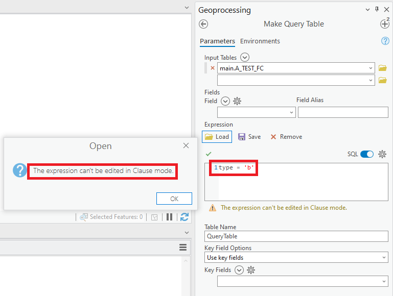

However, the Make Query Table tool doesn't seem to parse the SQL into the UI picklists:
Could the tools be standardized so that loaded .exp files are consistently parsed into "clause mode"? (It looks like the Make Query Table tool is the only tool that needs to be enhanced.)
Also, could my other notes in bold be considered?
