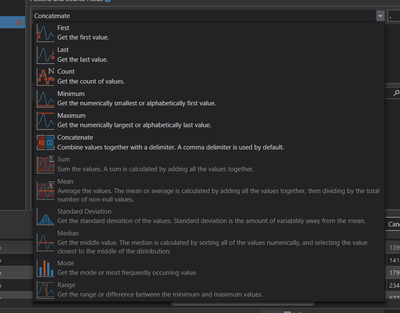

@KoryKramer @DrewFlater  The implementation of the concatenate option has been great, thank you, but what I see now is the need for a "concatenate UNIQUE" option.  See this tech support  example: https://support.esri.com/en-us/knowledge-base/how-to-concatenate-field-values-using-a-case-field-in-....
It lists the same value multiple times (i.e. 111).  I would like to see the option to only show unique values (111 would only show once).  My use of this today resulted in the same value populated numerous times making the field width in excess of 500 characters.  Would it be possible to add a checkbox option to only return unique values?

Yes! Adding "Concatenate Unique" as a Summary Statistics "Statistic Type" option would be amazing. Concatenate is sort of useful but most of the time the results are unwieldy and require further processing to be useful.
