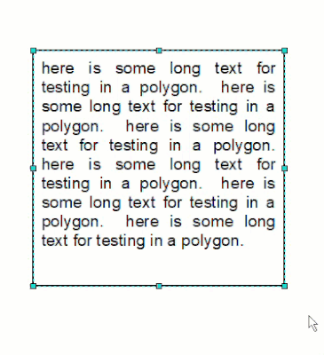

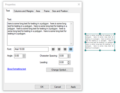

These options are available in ArcMap.
Text boxes that can be resized in map annotation
and have their properties edited

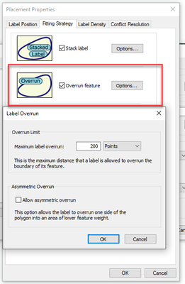

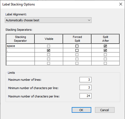

the ability to stack labels
and specify that the label does not overrun the edges of the polygon
