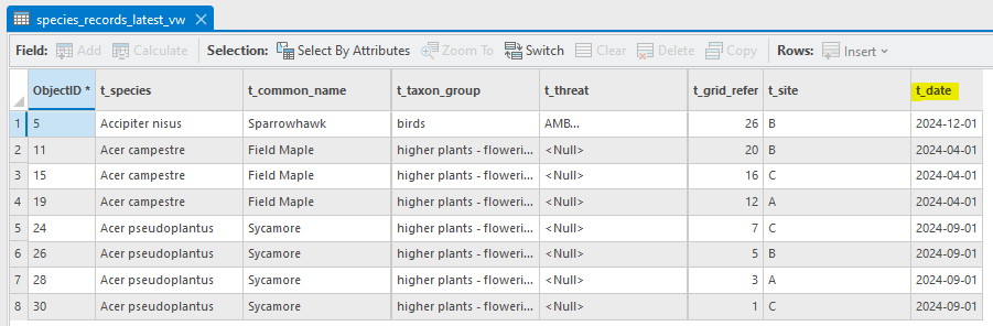

I have a SQL query that works in a FGDB database view. (Source: Selecting the most recent records based on unique values in another field)
--species_records_latest_vw
select
    s.*
from
    species_records s
inner join
    (select
        t_species,
        max(t_date) as t_date
    from
        species_records
    group by
        t_species) l
    on s.t_species = l.t_species
       and s.t_date = l.t_date

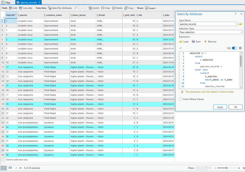

There are scenarios where I want to use that logic in Select By Attributes; I don't want to create a view.
But as far as I can tell, that SQL doesn't work in a SQL expression subquery.
objectid in (
    select
        objectid
    from
        species_records s
    inner join
        (select
            t_species,
        from
            species_records
        group by
            t_species) l
ERROR 000358: Invalid expression
That SQL expression works in a mobile geodatabase and enterprise geodatabase, but not in a file geodatabase.
Mobile geodatabase:
Could FGDBs be enhanced so that they support that kind of complex subquery?
