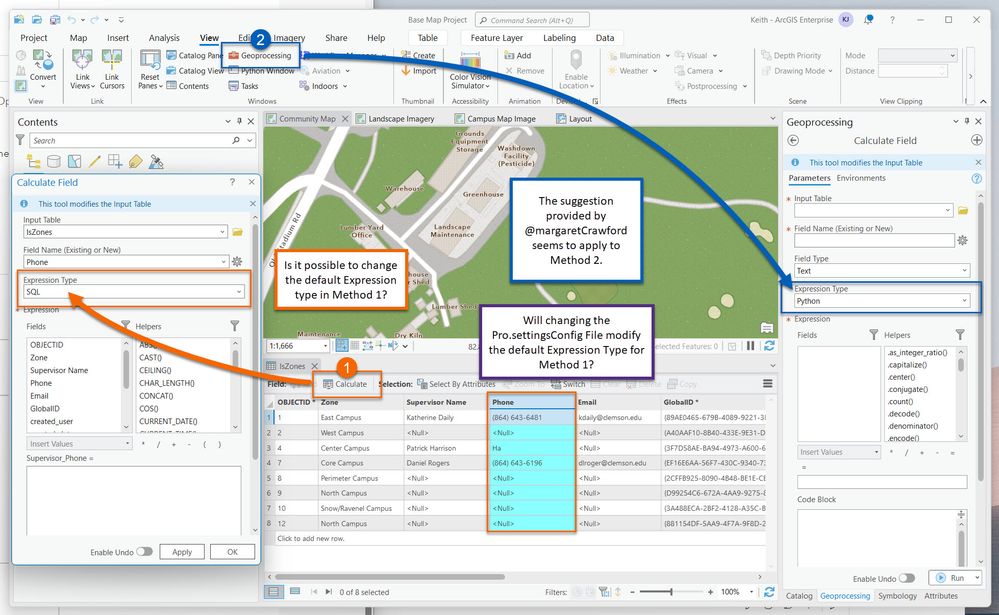

Hello @MargaretCrawford
If I'm understanding this correctly the ability to change the expression type only exist in the Geoprocessing Tool, not the field calculate option in the table?  Is there a way to change the default option when selecting field calculate from the table?

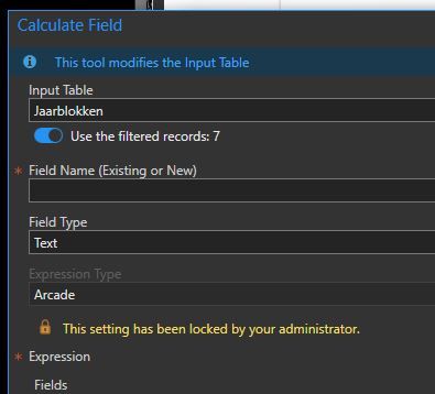

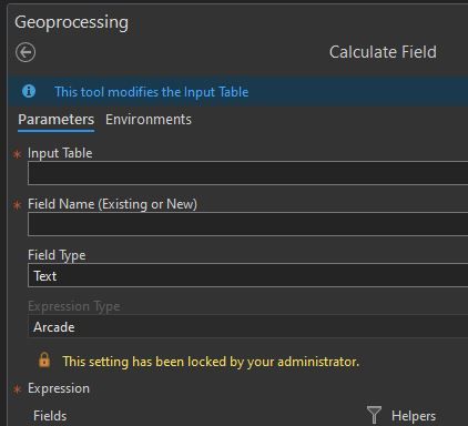

Gisbert61
Hi WardMitchell2,
I used the setting described in MargaretCrawford's post and it also sets Arcade as default (only) in the fieldcalculator as well.

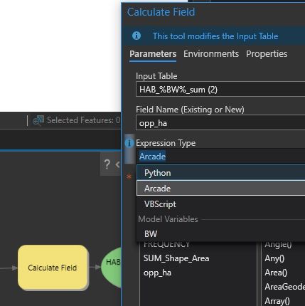

Only thing I encountered is when in Modelbuilder the field calculator defaults to Python
CU-KeithJones
@Gisbert61 @MargaretCrawford @WardMitchell2 please see below. If altering the config file does change the Calculate feature located in the Attribute Table, that is what is desired.
Will changing the config file alter the "Calculate" option in the Attribute table?Will changing the config file alter the "Calculate" option in the Attribute table?
Gisbert61
Yes, @CU-KeithJones,  both 1 and now default to Arcade. In fact I cannot use SQL or Python anymore (which is fine by me but your miles may vary )
But in Modelbuilder I still can choose between Arcade, Python and even VBscript:
