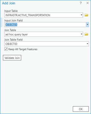

When creating a join in the attribute table using the Add Join geoprocessing tool:
The first thing I always do after creating the join is go into the FC properties and turn off a bunch of the join fields.
It would be more efficient to skip the FC Properties step and just enable/disable the join fields right in the Add Join window.
Could that functionality be added?

Hi Bud, you could use the Join Field tool, which has the option you are looking for using the Transfer Method and Transfer Fields parameters to select specific fields from the Join Table that will be added to the Input table. You can also alter field names, and other properties by setting the Transfer Method parameter to "Use Field Mapping". Keep in mind that joins made using the Join Field tool are permanent, whereas joins made using the Add Join tool are temporary.. Which I am not sure will work for your workflow.
https://pro.arcgis.com/en/pro-app/latest/tool-reference/data-management/join-field.htm
