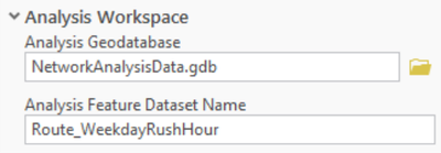

The geoprocessing tools used to create network analysis layers (Make Route Analysis Layer, etc.) have two new parameters:
  • Analysis Geodatabase – The existing file geodatabase workspace where the new network analysis layer's sublayer data will be stored.
  • Analysis Feature Dataset Name – The name to use for the new feature dataset that the tool will create in the analysis geodatabase to store the network analysis layer's sublayer data.
