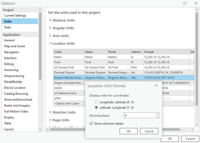

While it has been possible to change the display order for coordinates in ArcGIS Pro by going to Options > Units > Location Units > right-click Edit unit format:
Coming in ArcGIS Pro 3.0, the order of the Go to XY tool coordinate input boxes will reflect the format as defined in the project location units, for example XY or YX which will satisfy this request.
