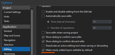

If the main problem is with inadvertently editing, there is a setting in ArcGIS Pro called 'Make newly added layers editable by default'
Unchecking that will ensure that you do not inadvertently edit layers - it will be necessary to explicitly check layers to make them editable.

ArcGIS Desktop is in mature support and will be retired March 1, 2026 so we won’t be considering this idea. We recommend that you migrate to ArcGIS Pro, our fully supported desktop GIS application.
The functionality you are requesting is available in ArcGIS Pro as described in the comments by my colleague @KoryKramer  .
