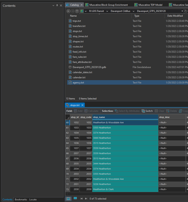

Not sure if this is related, but when opening tables from Catalog view, the TOC unexpectedly becomes a massive waste of space, unless you manually click back up into the catalog portion. It's bad enough it doesn't expand to the files or show any contents, can the dang thing just stay put?

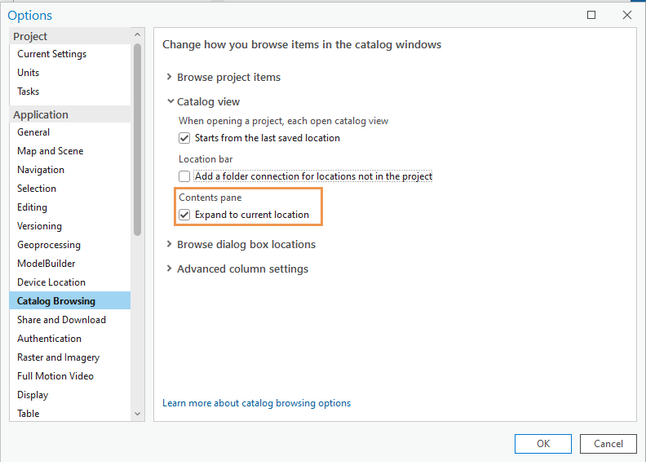

Hello @Meg_Southee_WCS, and everyone,
Thank you for your input.  The functionality that you were requesting in this idea is implemented in ArcGIS Pro 3.2.  In the Catalog view contents list, if you click a container (for example, a folder, or a file geodatabase, or a feature dataset) to browse into it, its parent container in the Catalog view Contents pane would be auto expanded (if it was not expanded already), with the this container selected.
(view in My Videos)
To use this functionality, you need to turn it on in the Options dialog, Catalog Browsing page, under Catalog view, Contents pane.  It is turned off by default.
@wayfaringrob, the functionality implemented for @Meg_Southee_WCS's idea is different from what you were requesting in your first comment. But as you mentioned, you already entered a separate idea for it (thank you), and further comment can be entered directly in your idea at  https://community.esri.com/t5/arcgis-pro-ideas/expand-quot-layouts-quot-and-quot-locators-quot-in/id... As to your second comment in this thread, about the empty Contents pane when you open a table, currently the Contents pane is no longer empty, showing some basic information about the table.  This now is actually the Contents pane for the table view.

Just so that you are aware, the functionality was turned off for me (it was not turned on by default).
